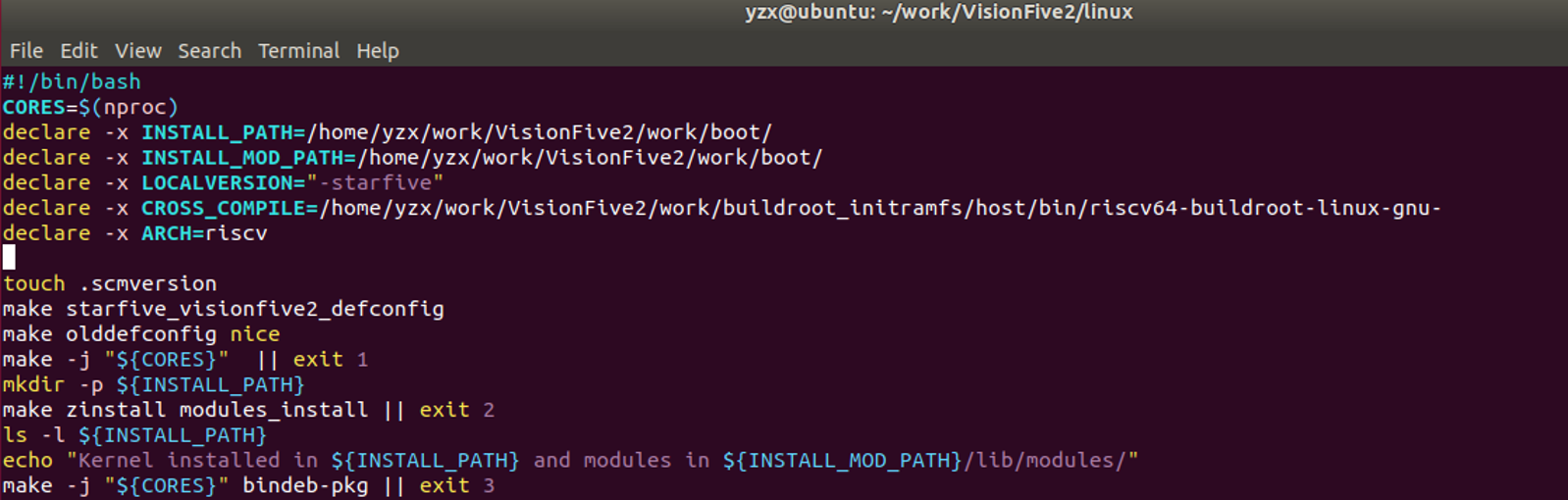

- Run ./build_kernel_vf2.sh script under
/VisionFive2/work/linux directory.Note:
- Script download address: build_kernel_vf2.shNote: To download this file, you need to register or login to RVspace.
- You need to change the target path of the script file to your own file path.
Figure 1. Example Running Process
