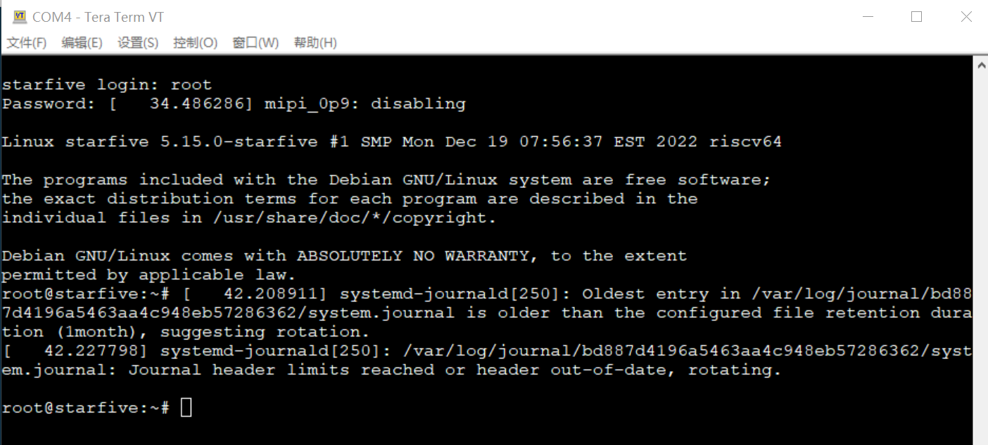

Figure 1. VisionFive 2 Startup Output Example
