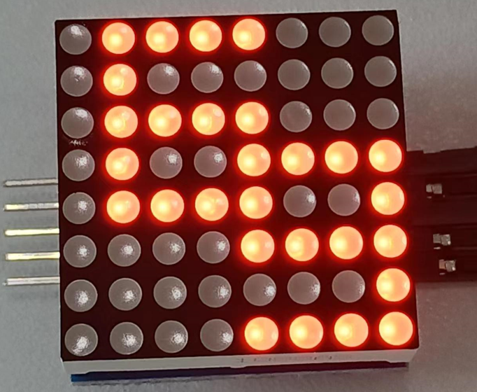

    The Led Matrix module displays with the StarFive logo.
    Figure 1. Example Output
