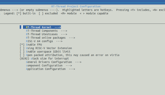

  4. To configure the crop RT-Thread, enter the following command under JH-7110 directory:
    $ cd rtthread/bsp/starfive/jh7110
    $ cp configs/vf2_defconfig .config
    $ cp configs/vf2_rtconfig.h rtconfig.h
    $ scons --menuconfig
    Tip: Menuconfig is a graphical configuration tool that is a feature in RT-Thread 3.0 and above versions. It allows for free cropping of kernels, components, and software packages, allowing the system to be built in a building block manner.
    Figure 1. RT-Thread Configuration
