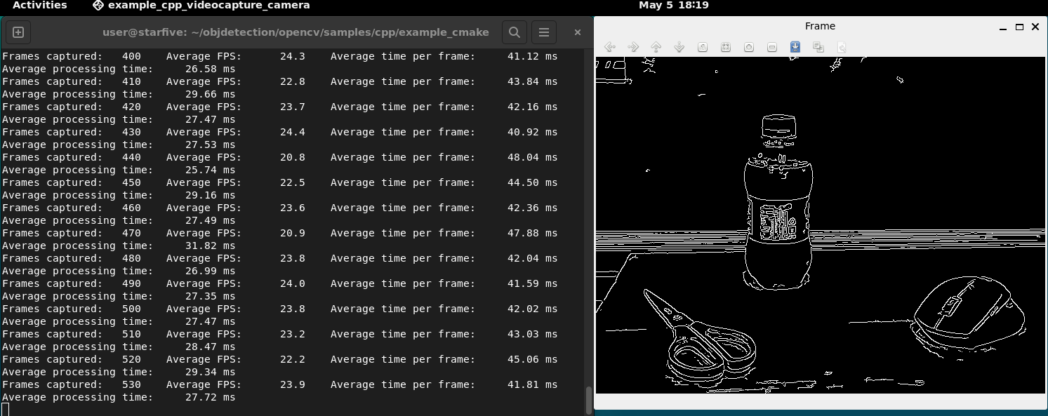

  • HDMI monitor displays the real-time video stream from a webcam;
  • The terminal where the image edge detection demo code is run will print the running frame rate and other information in real-time.
Figure 1. Image Edge Detection Application
