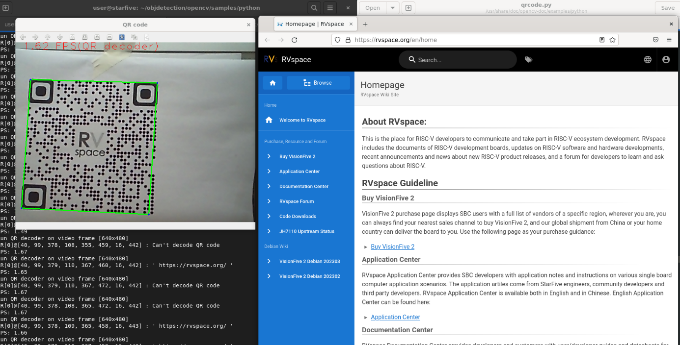

/dev/video4 represents the USB camera.Result:
- HDMI monitor displays the real-time video stream from a webcam;
- A real-time bounding box marks the position of the QR code, and QR code decoding is initiated.
- The decoding result like URL will be printed on the terminal where the demo code is run;
- The real-time frame rate is displayed in the top left corner. The frame rate is approximately 5.5 fps when performing standalone recognition, and approximately 1.8 fps for recognition and decoding combined.
- Python sample can utilize Firefox to open the website that is successfully decoded.
- The detection speed is 4-6 fps (for locating), and the decoding speed is approximately 1.5 fps (for extracting the content of the QR code).
