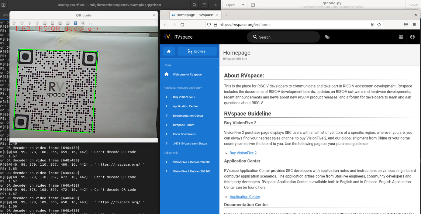

  • HDMI monitor displays the real-time video stream from a webcam;
  • A real-time bounding box marks the position of the QR code, and QR code decoding is initiated.
  • The decoding result like URL will be printed on the terminal where the demo code is run;
  • The real-time frame rate is displayed in the top left corner. The frame rate is approximately 5.5 fps when performing standalone recognition, and approximately 1.8 fps for recognition and decoding combined.
  • Python sample can utilize Firefox to open the website that is successfully decoded.
  • The detection speed is 4-6 fps (for locating), and the decoding speed is approximately 1.5 fps (for extracting the content of the QR code).
Figure 1. QR Code Detection and Decoding
