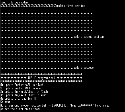

  4. Power up, you will see an output like this:
    CCCCCCCCCCCCCCCCCCCCC

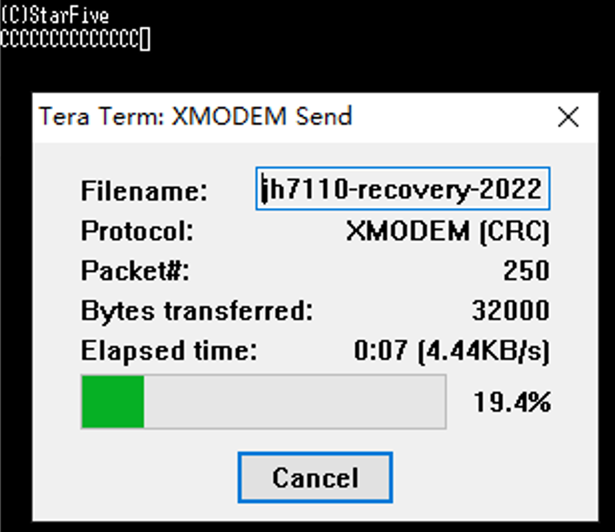

  5. Transfer the latest recovery binary (jh7110-recovery-<Version>.bin) by XMODEM. The recovery binary is located at: https://github.com/starfive-tech/Tools/tree/master/recovery.
    Tip: <Version> indicates the version number of the recovery file. Make sure you use the latest version.
    Figure 2. Example Output

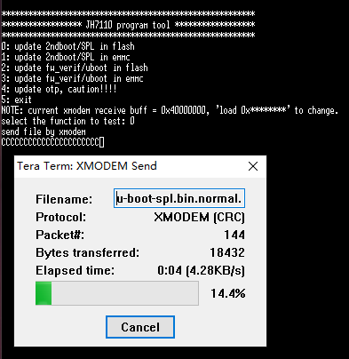

  6. Type 0 and press Enter on your keyboard to update SPL binary <u-boot-spl.bin.normal.out>.
    Figure 3. Example Output

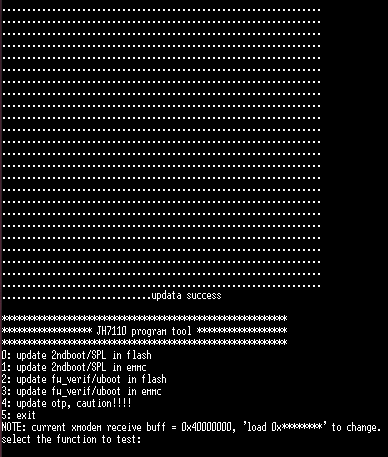

  7. Type 2 and press Enter on your keyboard to update U-Boot binary <devkits_fw_payload.img>.
    Figure 4. Example Output
