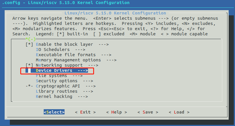

  2. Enter the Device Drivers menu option.
    Figure 1. Device Drivers

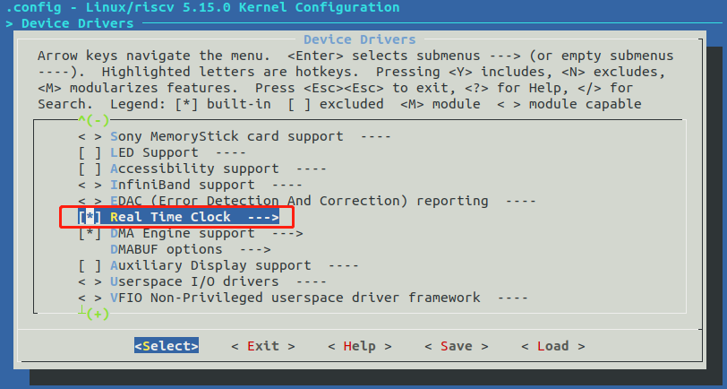

  3. Enter the Real Time Clock menu option.
    Figure 2. Real Time Clock

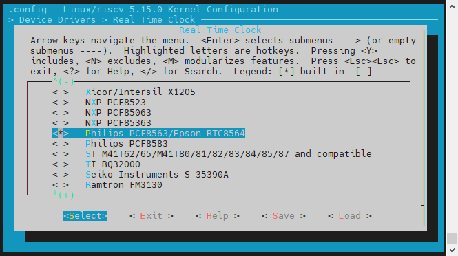

  4. Select the Philips PCF8563/Epson RTC 8564 menu option to enable the RTC driver.
    Figure 3. Philips PCF8563/Epson RTC 8564
