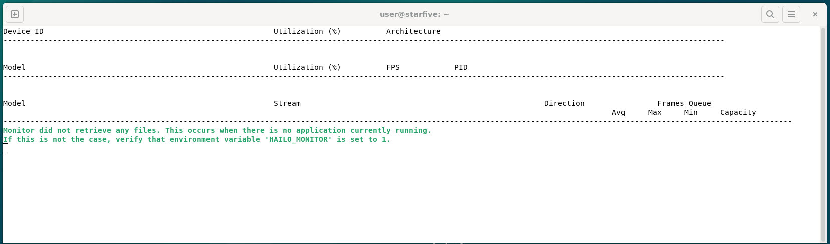

  1. Run the following command to enable Hailo monitor, which can monitor the utilization rate of NPU devices, models used, and FPS output in real-time:
    $ hailortcli monitor
    Figure 1. Enable Hailo Monitor

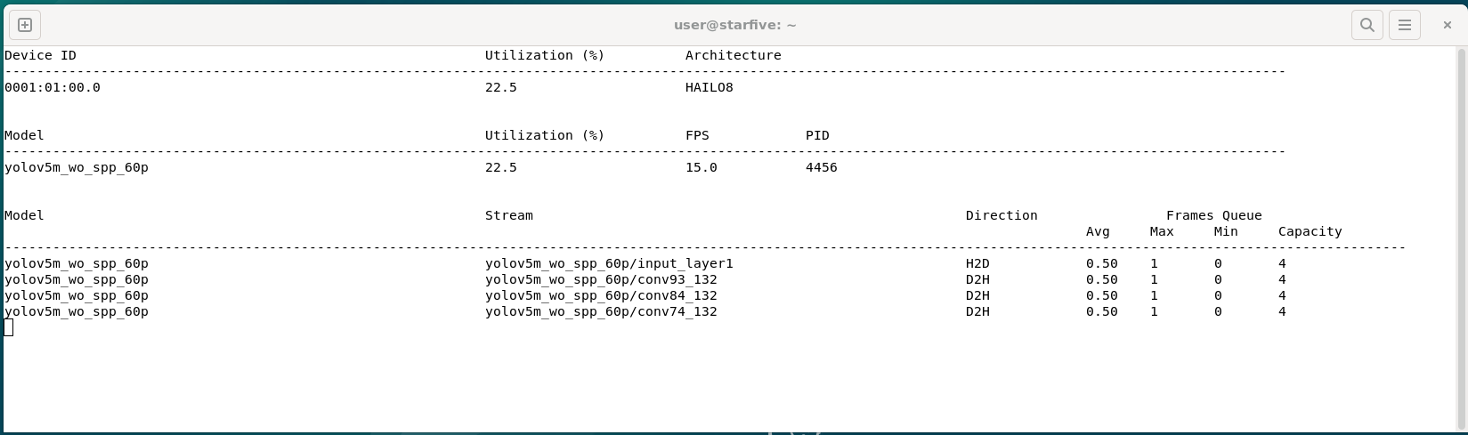

  3. When executing the demonstration case, HailoRT detects that the HAILO.MONITOR variable of this shell process is 1, and will output real-time monitoring data of the NPU module:
    Figure 3. Monitor Data

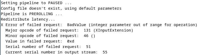

Otherwise, the following error will occur during runtime:
Figure 5. Error

      Note: When the following error occurs, check if the TAPPAS-WORKSPACE environment variable is missing.
      Figure 6. Error
      If this error occurs, you can set the environment variable: export TAPPAS-WORKSPACE=path_to-tappas/tappas/, where path_to-tappas is the path where the Tappas source code directory is located.
