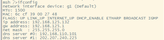

As shown in the figure below, when RT-Thread starts, it initializes GMAC and registers
the GMAC driver with the IwIP TCP/IP protocol stack. DHCP function is enabled by
default, and the IP address is successfully obtained from the DHCP network. GMAC can
work normally.Figure 1. GMAC Driver
