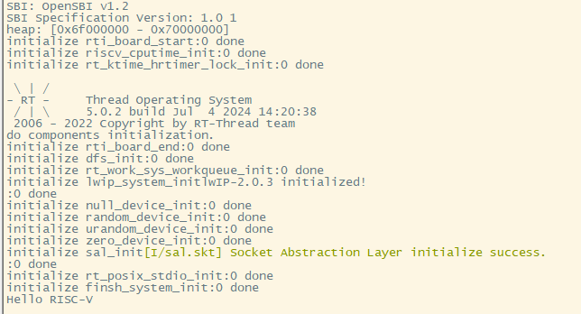

Power on: RT-Thread starts quickly after power on and runs the program. When
running to the main program, RT-Thread needs waiting for
the Linux side to send an IPI interrupt, while the Linux side is the master of
Rpmsg and needs to configure the control memory and shared memory of the virtual
queue.Figure 1. Power on

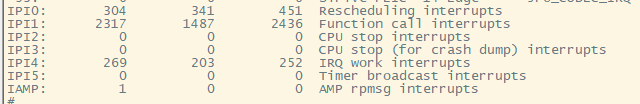

Running the following command on the Linux side can see the IPI interrupt sent
by RT-Thread to
Linux:
cat /proc/interrupts
Figure 4. IPI Interrupt

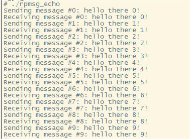

Run the test program
below:
rpmsg_echo
Tip: RVspace has provided the compiled applications and source code. This
application sends a string to the remote side of RPMsg, After receiving it,
RT-Thread will send the received string back to Linux, and the test result
is shown below:
