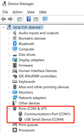

- Open Device Manager by typing Device Manager in the windows search box.
Click the drop-down arrow from Ports (COM & LPT) and find
the name of the connected serial port (e.g.: COM4).
Figure 2. Example

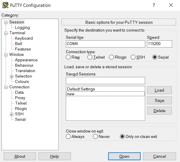

Download and install Putty by visiting this link.
Tip: Putty is an SSH and telnet client through which you can connect to the Carrier Board via SSH. You can skip this step if you already have Putty installed.
Open Putty to connect the PC to the Carrier Board.
