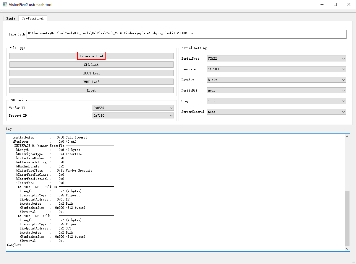

  1. Click Firmware Load, and Firmware will be automatically burnt.
    Figure 1. Burn Firmware

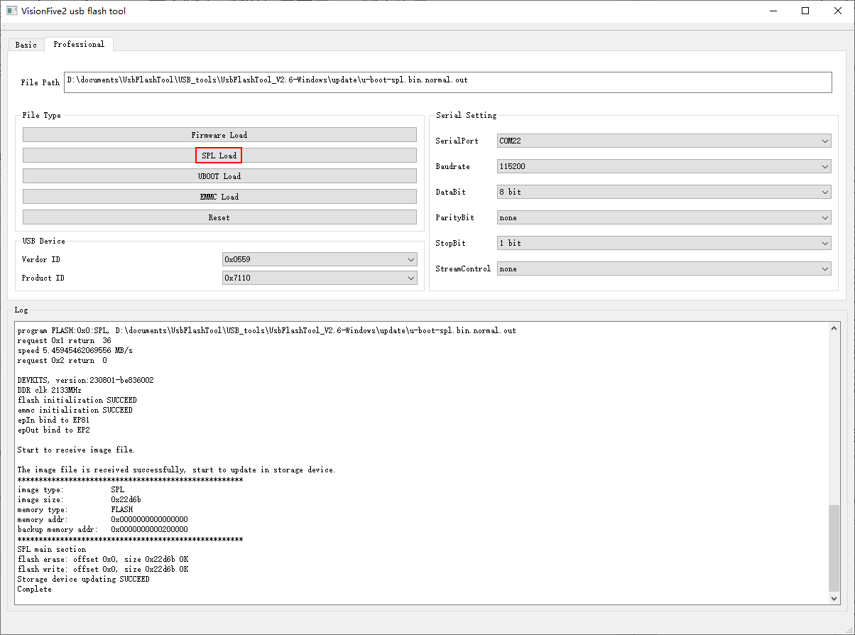

  2. Click SPL Load, and u-boot-spl.bin.normal.out will be automatically burnt into Flash.
    Figure 2. Burn SPL

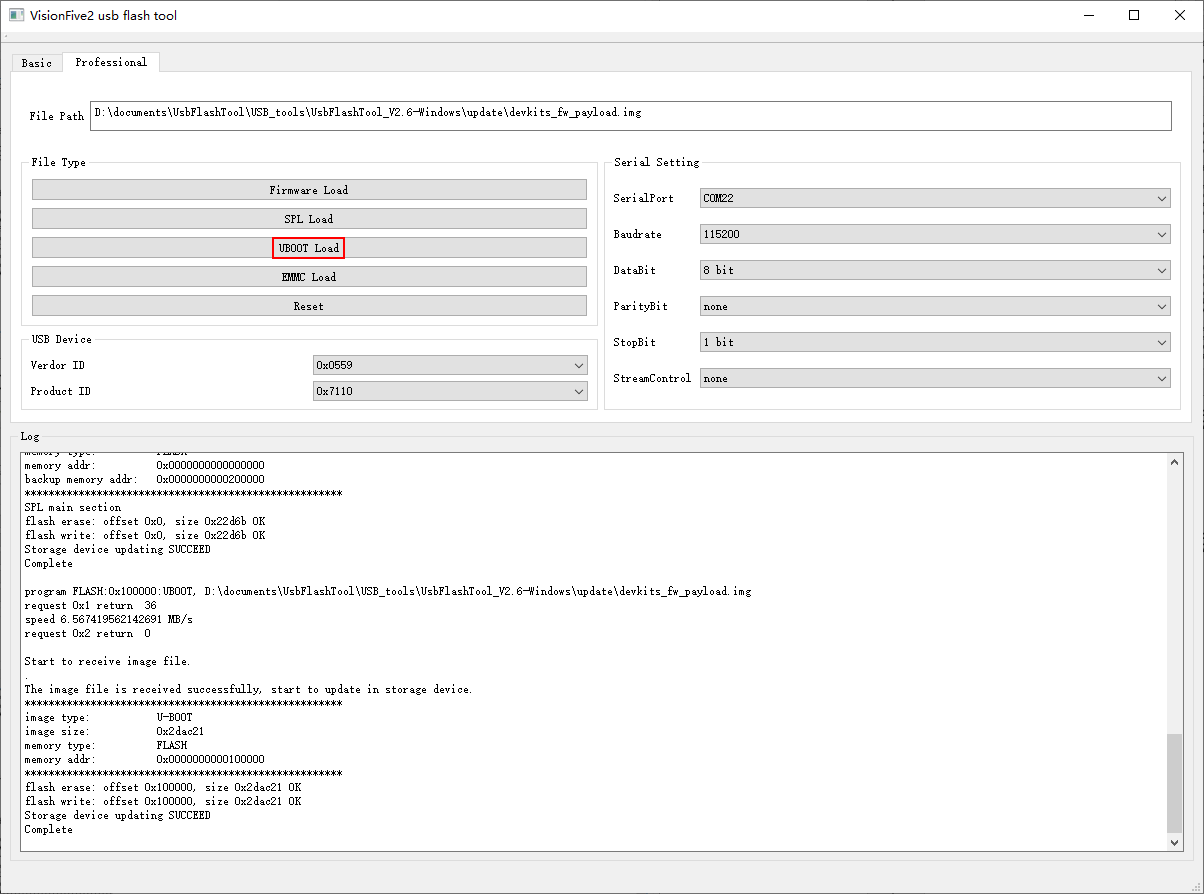

  3. Click UBOOT Load, and devkits_fw_payload.img will be automatically burnt into Flash.
    Figure 3. Burn UBOOT

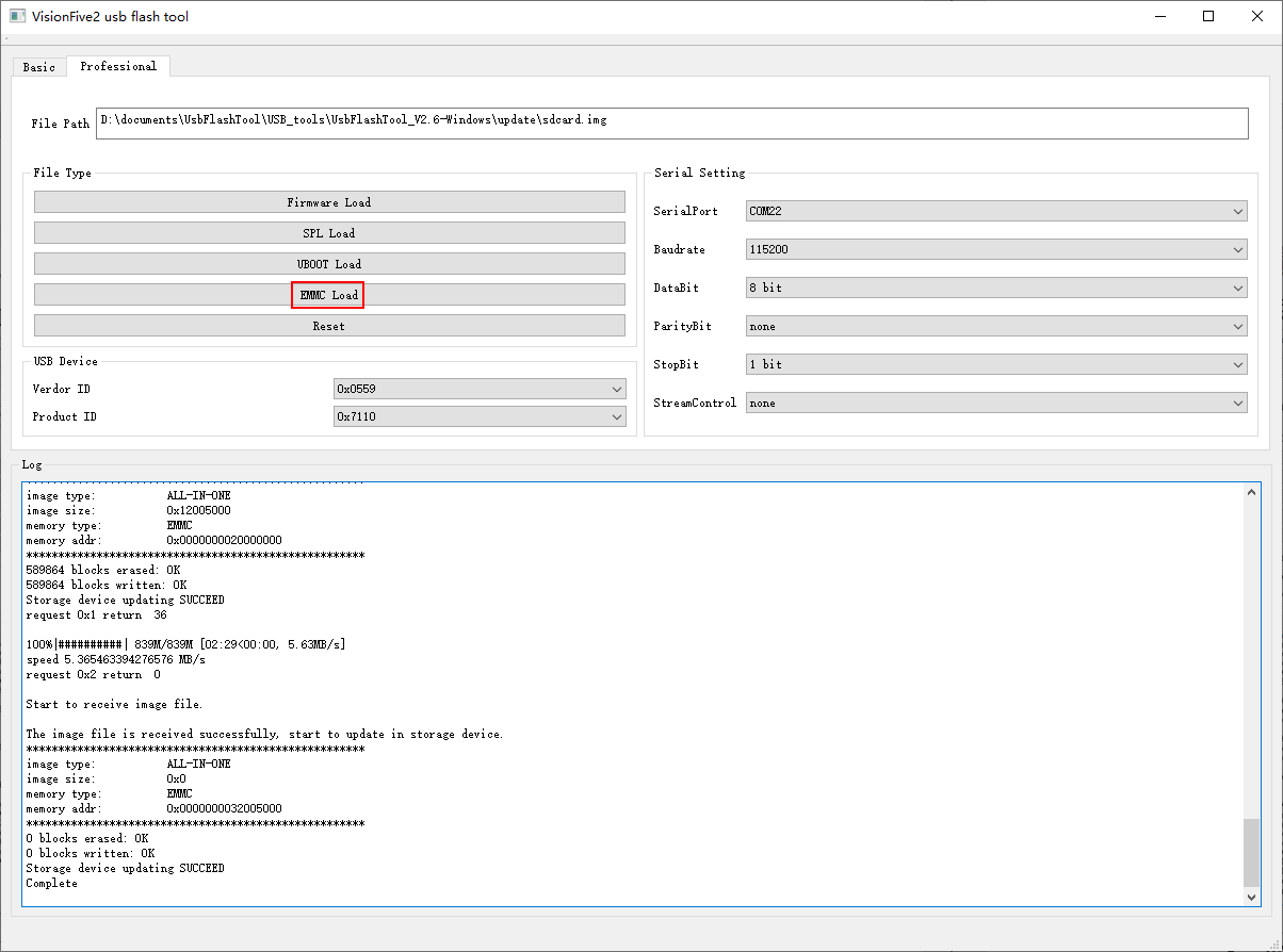

  4. Click EMMC Load, and sdcard.img will be automatically burnt into EMMC.
    Figure 4. Burn EMMC
    You will see the output Complete, which indicates that the image is burnt successfully.
