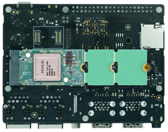

The Hailo-8L AI acceleration module is connected through the M.2 M-Key of VisionFive 2 or VisionFive 2 Lite. The figure below shows the VisionFive 2 AI Kit:
Tip: StarFive recommends that you use a heart sink or a fan for heat dissipation.
Figure 1. VisionFive 2 AI Kit
