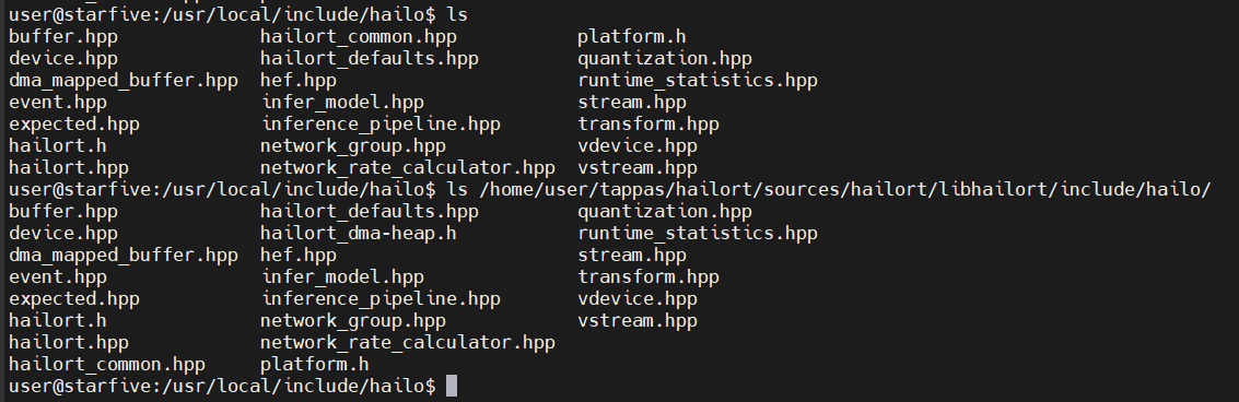

As shown in the following figure, after the compilation and installation of HailoRT, the hailort_dma-heap. h head file is missing from the installation path and needs to be copied to the corresponding path manually:Figure 1. Missing head file - Run the following command to copy the hailort_dma_heap.h head file to the corresponding path:
$ sudo cp hailort/libhailort/include/hailo/hailort_dma-heap.h /usr/local/include/hailo/

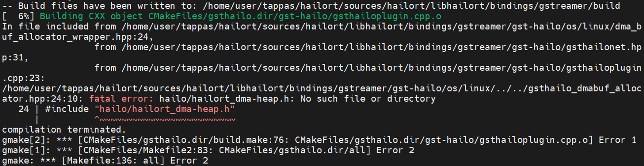

Otherwise, the following errors will be encountered during Tappas compilation and installation:Figure 2. Error

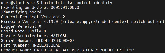

$ hailortcli fw-control identify
You can view the connected Hailo-8L module information:Figure 3. Hailo-8L Module Information
