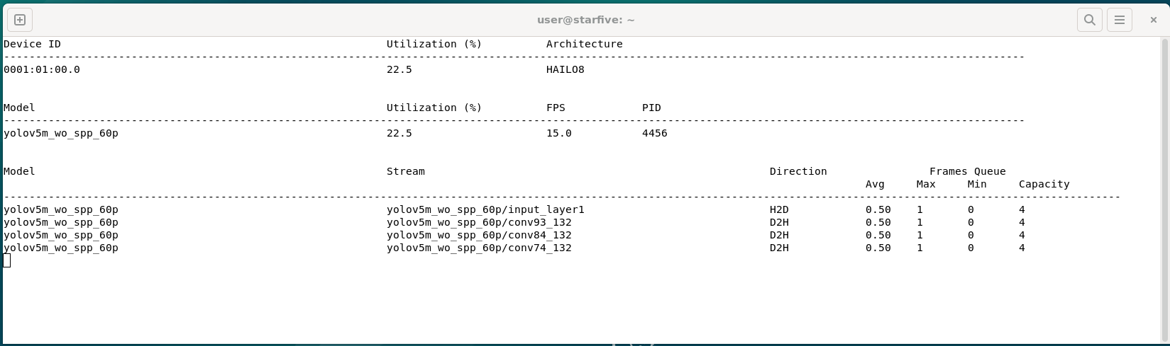

  1. Run the following command to enable Hailo monitor, which can monitor the utilization rate of NPU devices, models used, and FPS output in real-time:
    $ hailortcli monitor
    Figure 1. Enable Hailo Monitor

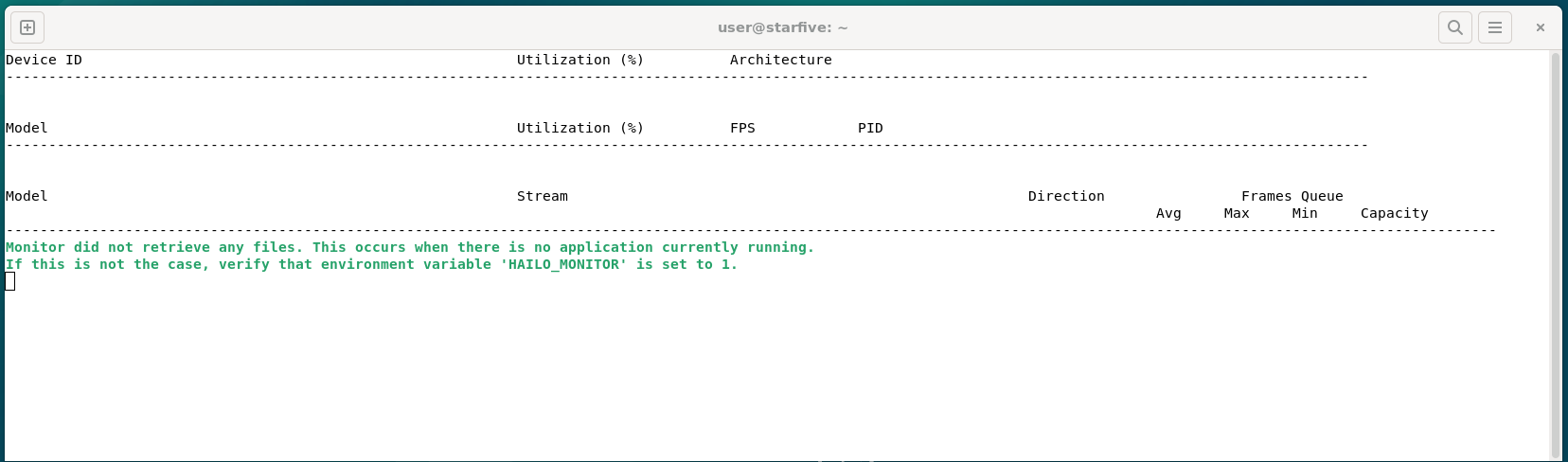

  2. Open another shell (this shell must be the one running the demo program), and specify the environment variables:
    $ export HAILO_MONITOR=1
    Figure 2. Specify environment variables
  3. When executing the demonstration case, HailoRT detects that the HAILO.MONITOR variable of this shell process is 1, and will output real-time monitoring data of the NPU module:
    Figure 3. Monitor Data

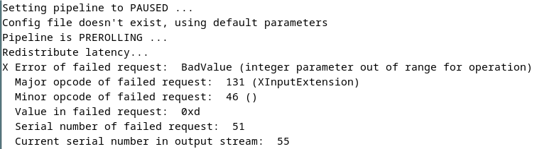

Note: The demo under Tappas uses GStreamer videosink with xvimagesink and ximagesink, while VisionFive 2's Debian uses Wayland protocol, these demos need to modify their startup scripts by changing the ximagesink in video_stink_ element to waylandink:
Figure 4. Change Startup Scripts
Otherwise, the following error will occur during runtime:
Figure 5. Error

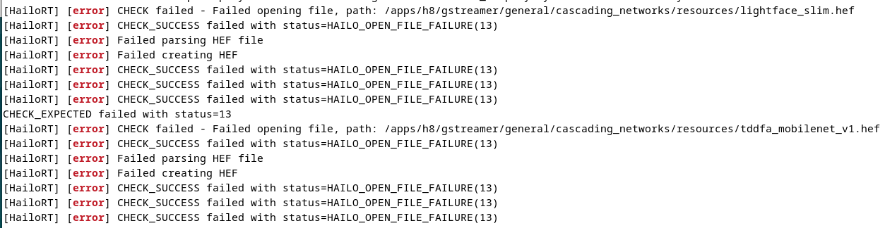

      Note: When the following error occurs, check if the TAPPAS-WORKSPACE environment variable is missing.
      Figure 6. Error
      If this error occurs, you can set the environment variable: export TAPPAS-WORKSPACE=path_to-tappas/tappas/, where path_to-tappas is the path where the Tappas source code directory is located.
