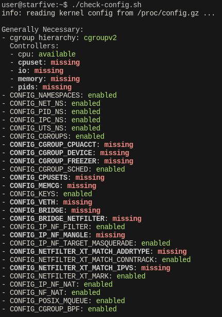

The Docker open source team has provided a script that can detect whether the kernel configuration meets Docker's running requirements. The source address is: https://github.com/moby/moby/blob/master/contrib/check-config.sh.
- Get script and run the following
command:
$ ./check-config.sh
The following is the example output:Figure 1. Example Output:
The output results are mainly divided into 2 parts:- Generally Necessary: Indicates the necessary configuration.
The
missingoptions in the figure need to be opened in the kernel configuration to recompile and burn the kernel to support Docker. - Optional Features: Indicates optional configuration, and can be opened as needed.

- From the example output, we can see that there are many missing options in the
necessary configuration. You can refer to this link to pull codes, switch
branches, and apply the default kernel options. After applying the default
options, configure the corresponding kernel options:

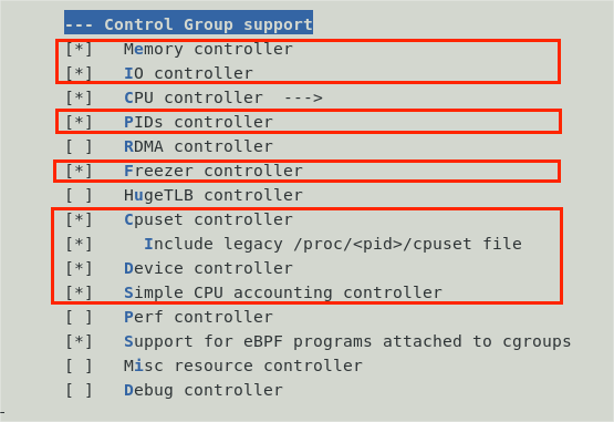

- To enable CONFIG_CGROUP_*, CONFIG_CPUSETS,
CONFIG_MEMCG and itms under Controller, you need to
enable following options under :
Figure 2. Configure Kernel Options

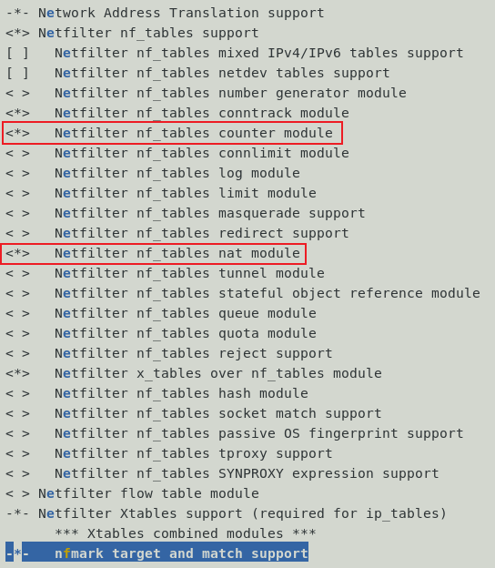

- After selecting the above options, you still need to enable the
following options under , otherwise, Docker will not start properly:
Figure 12. Netfilter nf_tables_support
