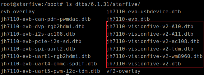

By enabling different device tree files, it is possible to achieve different functions or
support different peripherals on VisionFive
2. Taking default kernel
of Debian202403 image as an example, it supports the following different device tree
files:Figure 1. dtb Files
Note: Different boards use different dtb files:
jh7110-visionfive-v2.dtb: for Version 1.2A and 1.3B
board.
jh7110-visionfive-v2-ac108.dtb: for version 1.2A and
1.3B board with ac108 codec.
jh7110-visionfive-v2-tdm.dtb: for version 1.2A and 1.3B
board with tdm sound card.
jh7110-visionfive-wm8960.dtb: for Version 1.2A and 1.3B
board with wm8960 codec.

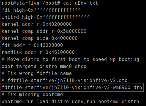

Modify uEnv.txt File
By modifying the uEnv.txt file, different device tree files can
be loaded when the board starts. For example, modify the
uEnv.txt file to use
jh7110-visionfive-v2-wm8960.dtb to support the wm8960
codec:Figure 2. Modify uEnv.txt File
