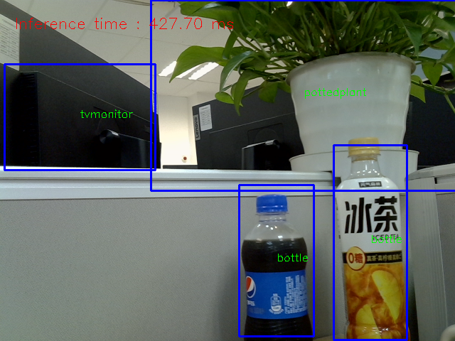

- HDMI monitor displays the real-time video stream from a webcam;
- HDMI monitor displays real-time drawings of bounding boxes, labeling the objects recognized by the model, and displaying their names;
- The inference time per frame is displayed on the upper left corner, which translates to an approximate inference frame rate of 2.5-3 fps;
