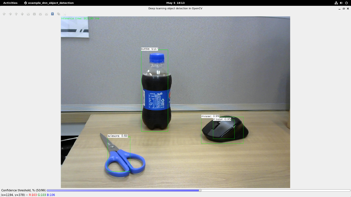

  • HDMI monitor displays the real-time video stream from a webcam;
  • HDMI monitor displays real-time drawings of bounding boxes, labeling the objects recognized by the model, and displaying their names and confidence level;
  • The upper left corner displays the inference time per frame, which translates to an approximate inference frame rate of 1 - 1.5 fps;
Figure 1. General Object Recognition based on YOLO-V3 Model
