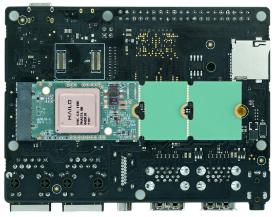

The Hailo-8L AI acceleration module is connected through the M.2 M-Key of VisionFive 2, as shown in the following figure:
Tip: StarFive recommends you to use a heart sink or a fan for heat dissipation.
Figure 1. VisionFive 2 AI Kit
