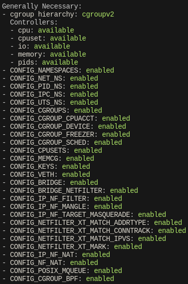

After replacing and starting the corresponding kernel, follow the method in Required Kernel Options to
check Docker kernel options again:
Result:
All kernel options that display missing
in the required kernel options
have been updated to enabled
, indicating that all required kernel
options are turned on.
