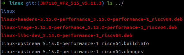

- After compilation, the following files and dtb files will be generated in the upper directory:
Figure 1. File

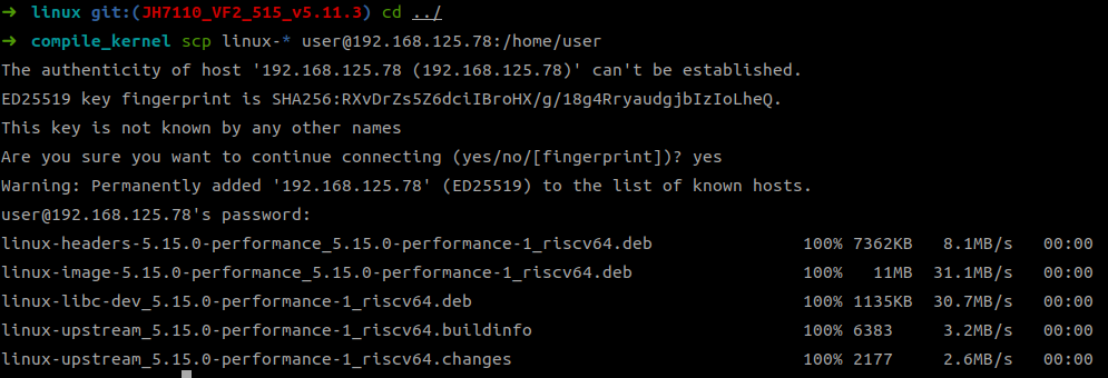

- Transfer the compiled Debian package and dtb files through network (SCP) or portable storage medium (USB) to VisionFive
2. The following figure shows an example output of file transfer over the network:
Figure 3. Example Output

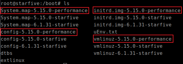

- After installation, the files under /boot will be updated into:
Figure 4. Files under /boot
