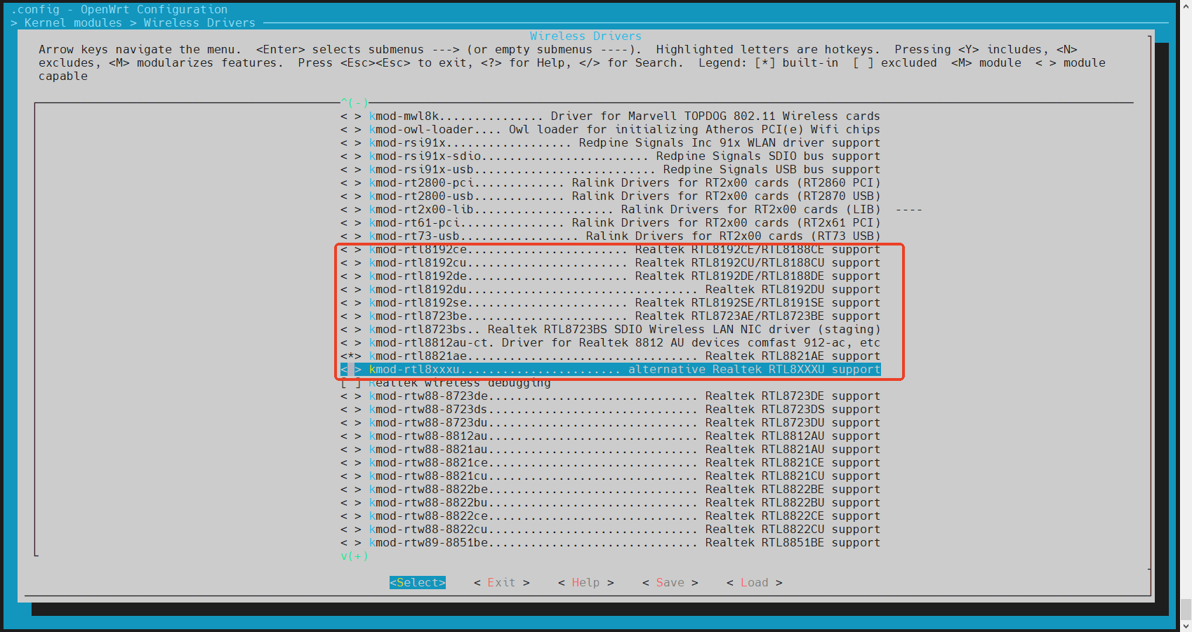

Due to the lack of WiFi modules on VisionFive 2 or VisionFive 2 Lite, you need to purchase a WiFi Dongle. OpenWrt supports dozens of WiFi drivers, and the RTL8821AE PCI interface driver is chosen here for its easy availability. On VisionFive 2 or VisionFive 2 Lite, there is an M.2 M-key interface, which needs to be connected to the NVME M.2 M-key to a/e key interface board to connect to the RTL8821AE module.
In the menu configuration GUI, follow the steps to configure wireless connection:
  1. Select kmod-cfg80211, kmod-mac80211, kmod-rtl8821ae in the configuration menu bar in the following order:
    Kernel modules > Wireless Driver > kmod-cfg80211, kmod-mac80211, kmod-rtl8821ae

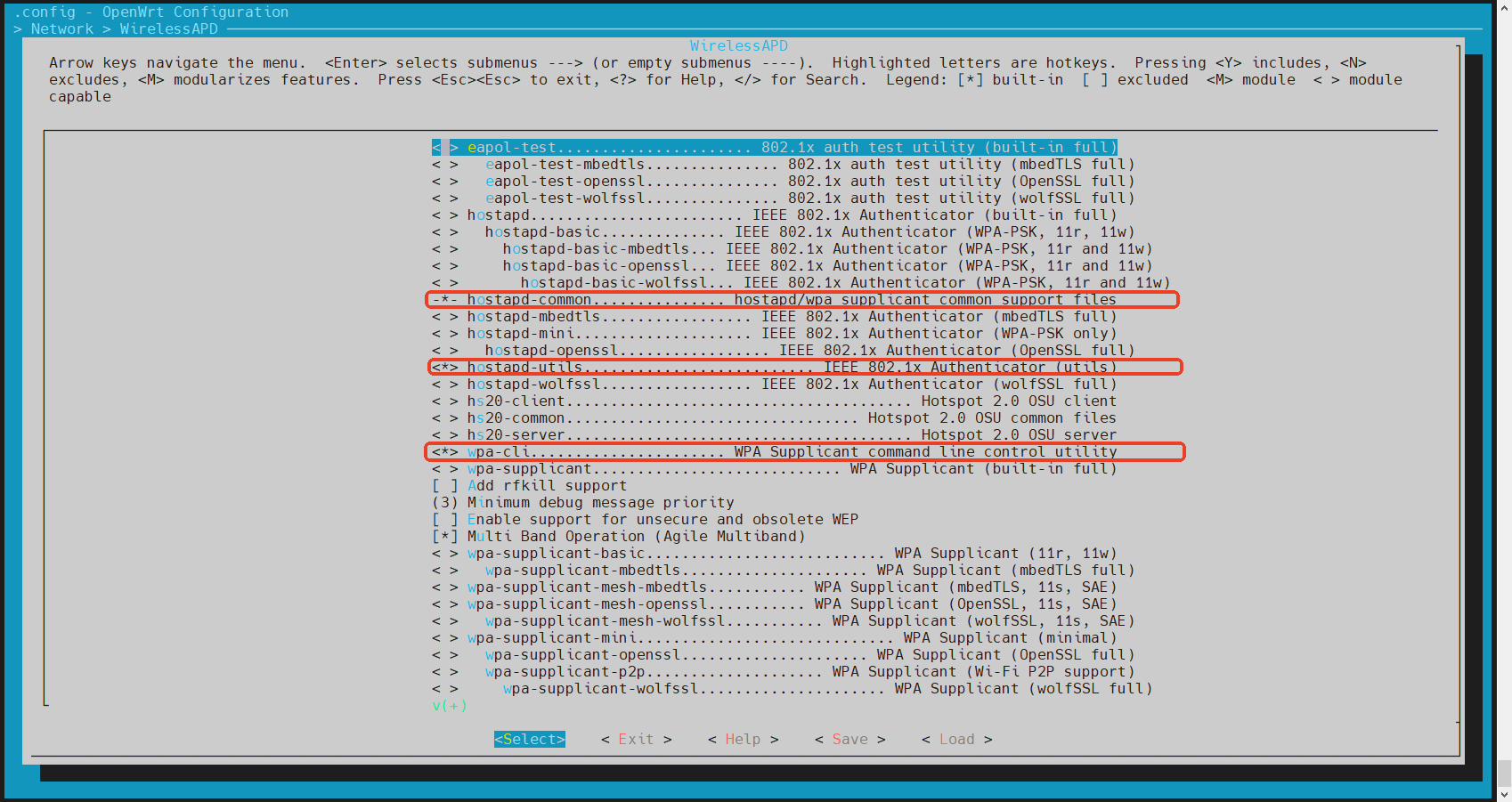

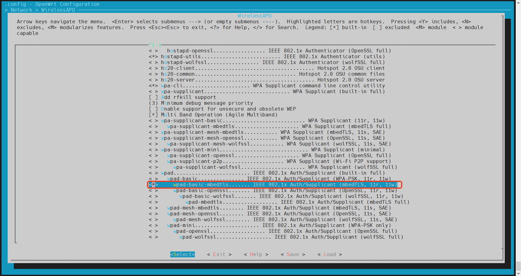

  2. Select wpad-basic-mbedtls, hostapd-common, wpa-cli, hostapd-utils in the configuration menu bar in the following order:
    Network > WirelessAPD > wpad-basic-mbedtls, hostapd-common, wpa-cli , hostapd-utils

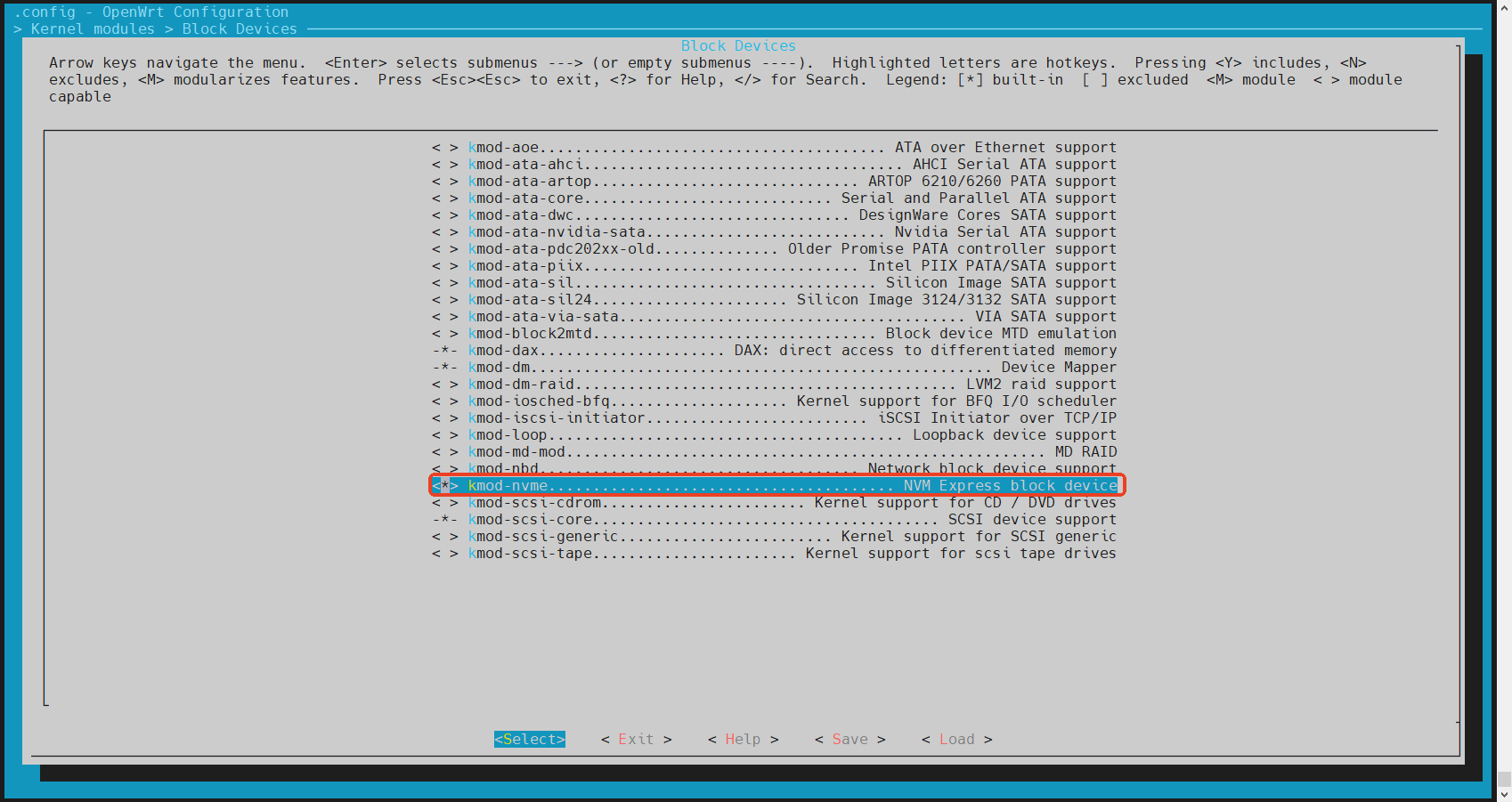

  4. Enable NVMe support by selecting:
    Kernel modules > Block Devices > kmod-nvme
