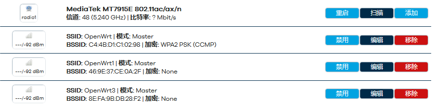

- After configured success, save and apply all configuration information. The correctly set device will be displayed as shown in the following figure:
Figure 1. Device

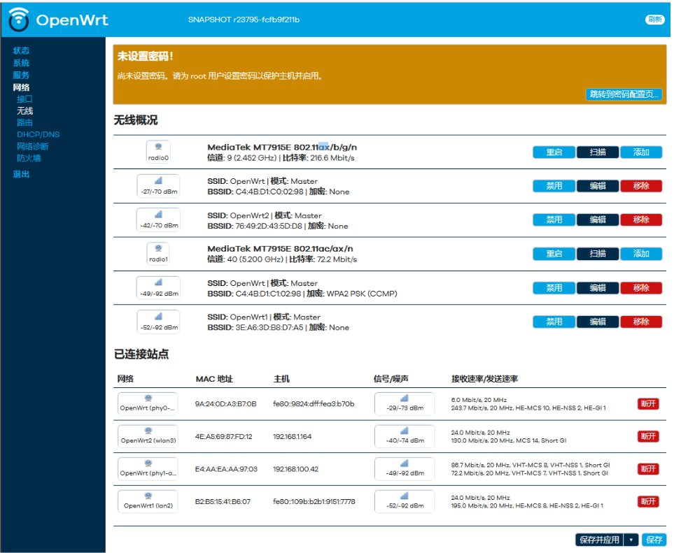

After the device is successfully connected, the wireless information and connection site will be displayed as follows:Figure 2. Wireless Information & Connection Site

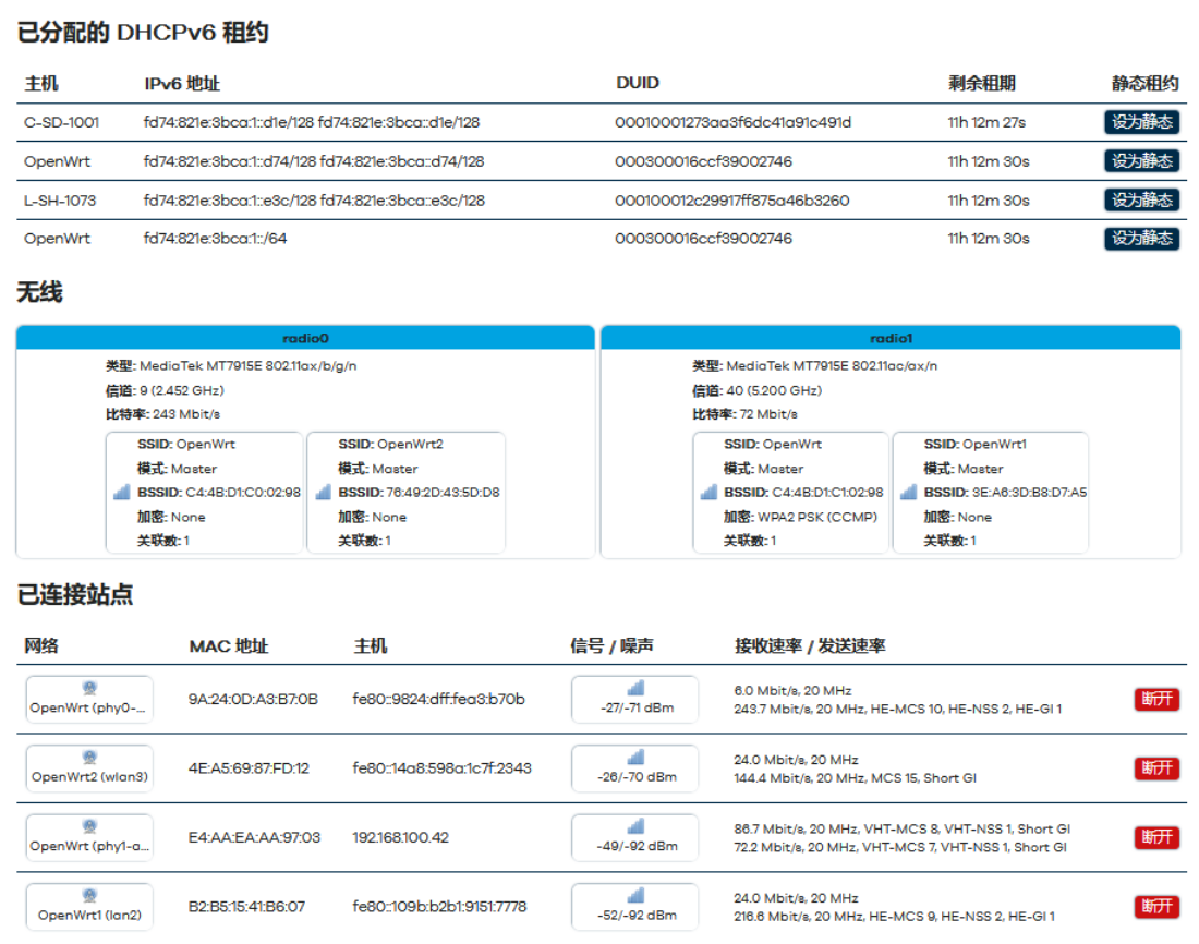

Other pages will also change accordingly, such as the homepage status:Figure 3. Homepage Status
