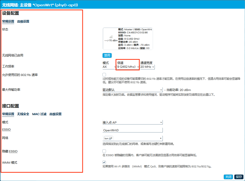

In Network Settings, click 添加(add) to create 2.4G and 5G networks respectively with the same mode, same SSID, and same encryption method to achieve simultaneous dual band, as shown in the following figure.
Figure 1. Set Network
Note: Except for the different channels in the red box on the right side (one is 9:2.4G and the other is 48:5G), all configurations on the left side should be the same.

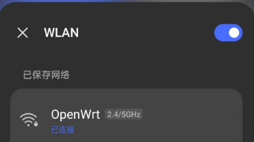

  • When connected, the mobile phone displays that 2.4G and 5G are integrated into one network.

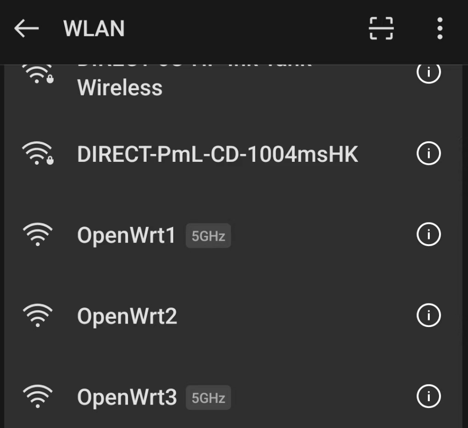

  • If the SSID is different, 2.4G and 5G networks will be displayed separately:
    • 2.4G: OpenWrt2
    • 5G: OpenWrt1 and OpenWrt3
