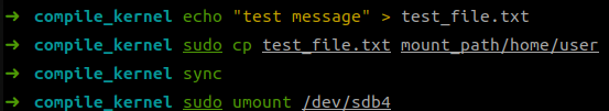

- Execute the following command to create test file:
$ echo "test message" > test_file.txt - Execute the following command to copy the file to target path:
$ sudo cp test_file.txt mount_path/home/user && sync - Execute the following command to unmount partition:
$ sudo umount /dev/sdb4Figure 1. File Copying
