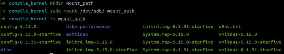

$ mkdir mount_path- The 3rd path (/boot path):
$ sudo mount /dev/sdb3 mount_pathThe following is the example output:Figure 1. Example Output
Result: After mounting, files in the /boot path of the Debian system can be viewed in this path.
