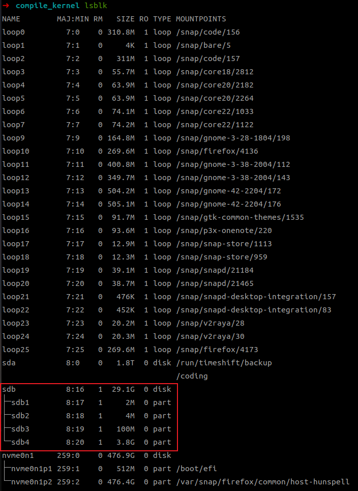

    - Insert a Micro-SD card with a burned Debian system (Debian202403, which was manually replaced with the kernel as mentioned earlier) into the compilation host, and execute the following command on the Ubuntu system to check the SD card partition:
$ lsblk
Figure 1. Example Output
As shown in the above figure, the system has read the SD card device and its partition information.
