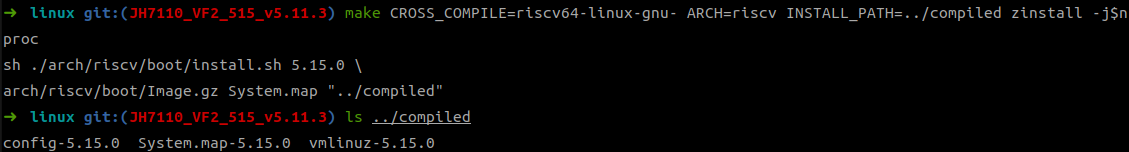

- Execute the following command to compile and generate files such as config, system.map, and vmlinuz to the specified path:
$ make CROSS_COMPILE=riscv64-linux-gnu- ARCH=riscv INSTALL_PATH=../compiled zinstall -j$(nproc)
The following figure is an example output:Figure 1. Example Output

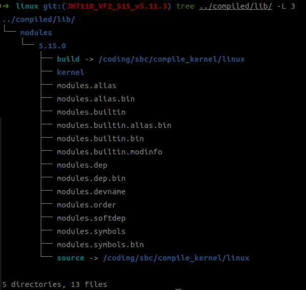

- (Optional) Execute the following command to compile and generate files to the specified path:
$ make ARCH=riscv CROSS_COMPILE=riscv64-linux-gnu- INSTALL_MOD_PATH=../compiled modules_install
Note: If the new kernel does not involve changes to the driver module, it can be omitted and the default kernel's driver module will still be used.The following figure is an example output:Figure 2. Example Output
Figure 3. Example Output
Note: There is no link between build and source in the corresponding path of the Debian image. The corresponding item in the above figure can be deleted.
