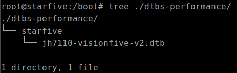

  1. After compiling and installing the kernel Debian package, create the path to place the dtb files:
  2. Execute the following command to set a new dtb addressing path for the new kernel boot option:
    $ mkdir -p /boot/dtbs-performance/starfive
    And place the device tree file under the compiled kernel source code in this path:

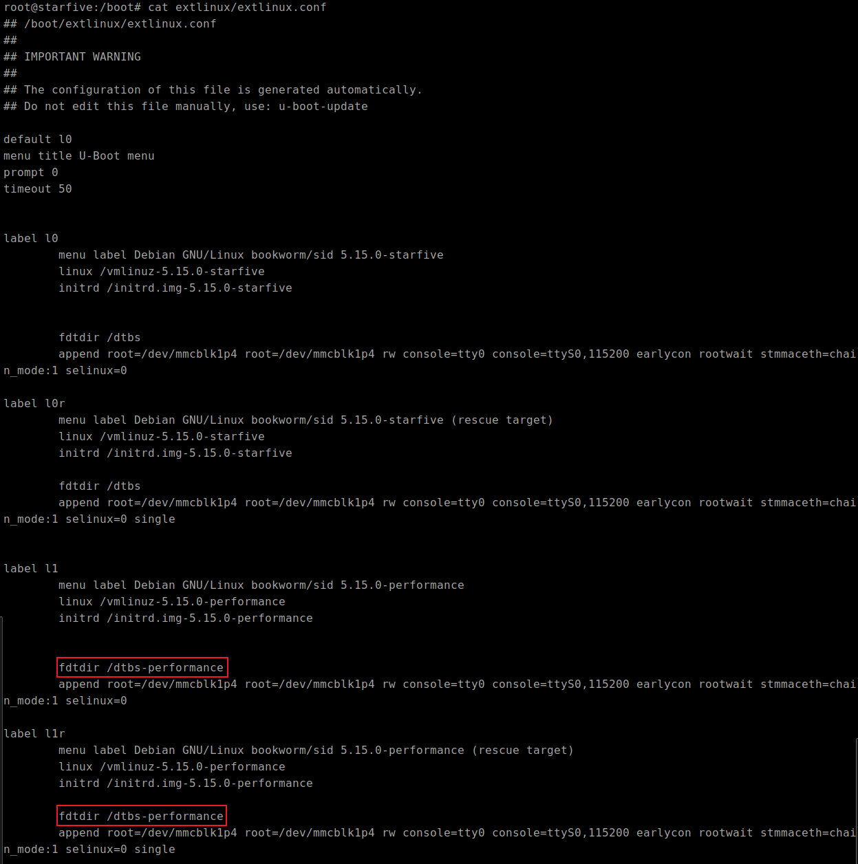

  3. Modify extlinux/extlinux.conf file:
    Figure 2. Modify File

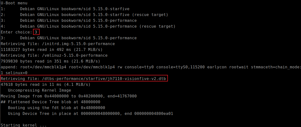

After powering on, select the newly added kernel option in the U-Boot menu. As shown in the following two images, select the kernel boot options 3 to see that the corresponding device tree files have been correctly loaded:
Figure 3. Kernel Boot Option-3
