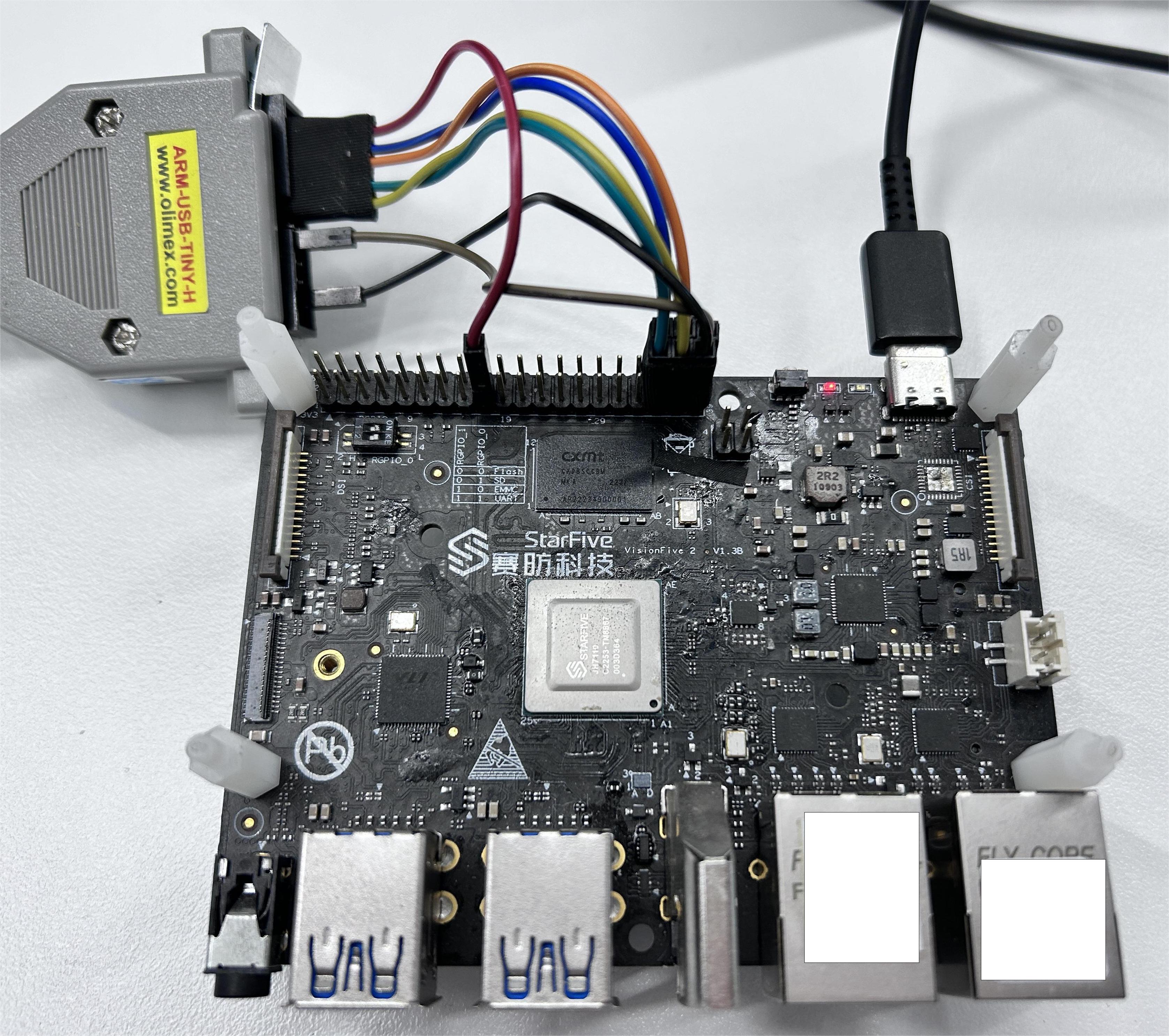

- Connect the Olimex connecter into the following corresponding pins. The
following figures show the JTAG port schematics and connection diagram.
Figure 2. JTAG Schematics
Figure 2. Connection Diagram
Tip: You can executelsusbcommand to judge whether the system has recognized the device. - In the folder where you store the unzipped package, click to enter
