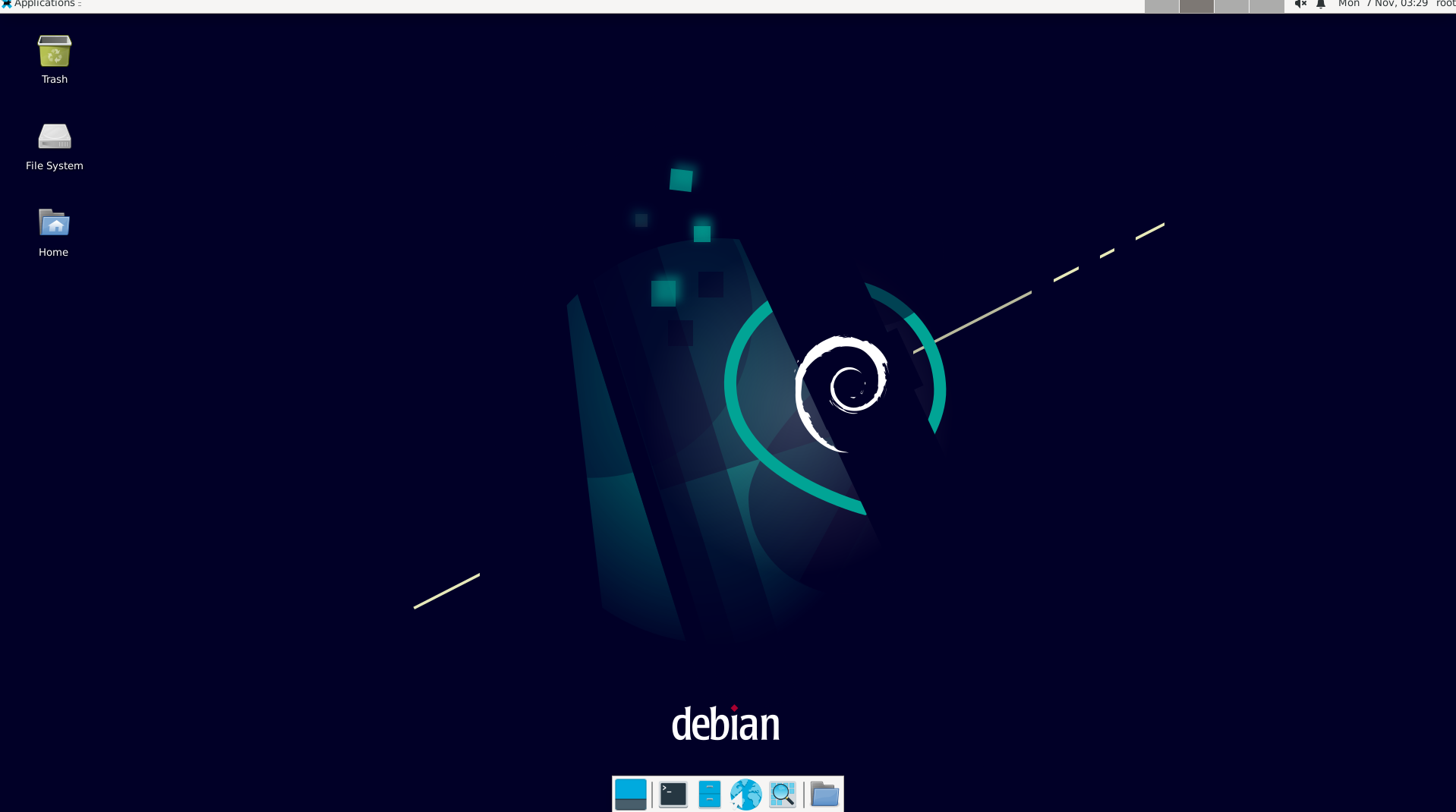

- After the HDMI of the display screen is connected, insert the micro-SD card with the Debian image into the VisionFive 2 and power on.
- After the desktop login system is displayed, you can use the keyboard and mouse on VisionFive 2.
Enter the credentials as follows:
- Username: user
- Password: starfive
Result:You will see the following interface:
Figure 1. Debian Interface
