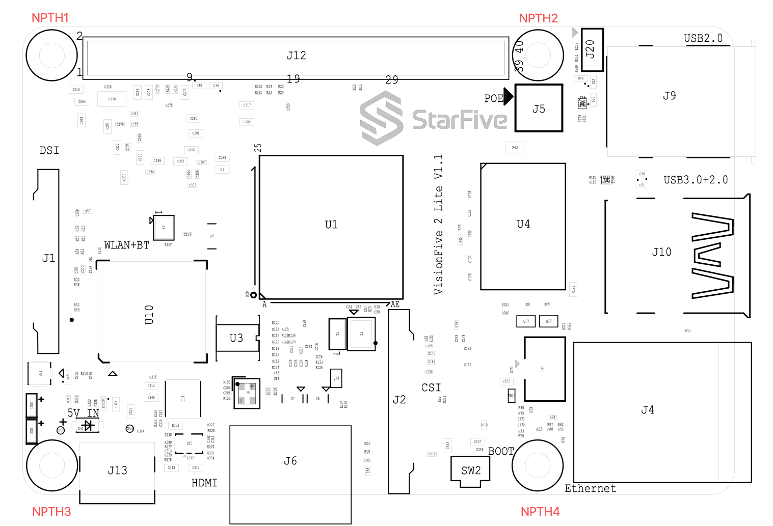

Using Spacers for NPTHs
During the use of VisionFive 2 Lite, avoid contact with hard objects that may cause damage. Thus, StarFive recommends that you use spacers for the following NPTHs (Non Plating Through Hole):
Figure 1. NPTHs on VisionFive 2 Lite

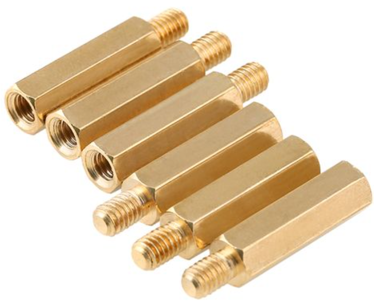

For spacers, StarFive strongly recommends that you use the copper columns or studs with the following specifications:
  • Single head hexagonal copper columns (Size: M2.5*10+6mm)
    Figure 2. Single head hexagonal copper columns

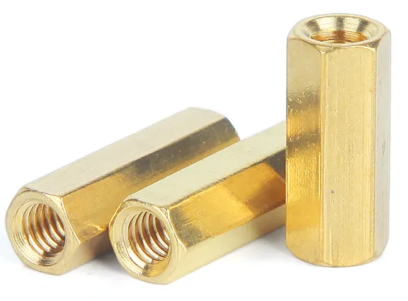

  • Double way hexagon copper studs (Size: M2.5*4)
    Figure 3. Double way hexagon copper studs

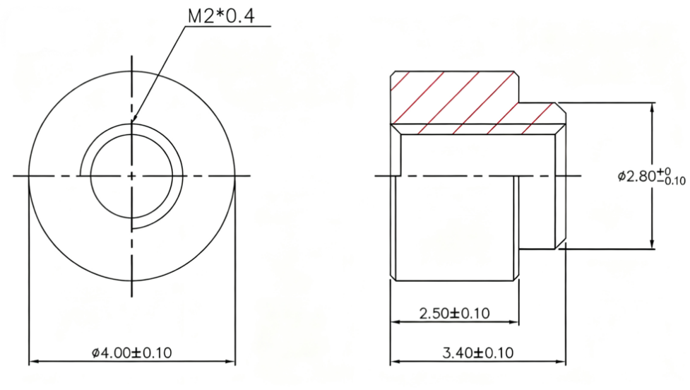

Note: The recommended SSD mounting screw for VisionFive 2 Lite is M2 × 3 mm or M2 x2.5 mm.
Figure 4. M2 Standoff Specification
