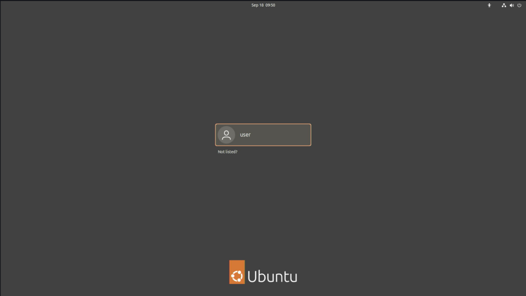

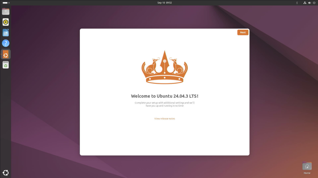

Perform the following steps to log into Distro:
  1. Connect a display to VisionFive 2 Lite via HDMI.
  2. Insert the TF card with the Ubuntu image into VisionFive 2 Lite and power it on.
  3. Enter the credentials as follows:
    • Username: user
    • Password: starfive
  4. You can log into Ubuntu OS by:
    • Using Desktop over HDMI
    • Using SSH over Ethernet
    • Using a USB to Serial Converter
