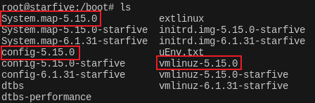

- Place the files System.map-5.15.0, config-5.15.0 and vmlinuz-5.15.0 under /boot path:
Figure 1. Place Files

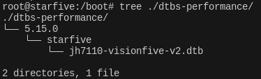

- The device tree file can refer to the default path, creates a new path corresponding to the version (/boot/dtbs performance/5.15.0/starfive in this example ), and place jh7110 visionfive v2.dtb in it:
Figure 2. Place Files

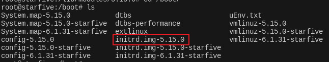

Figure 4. Generate initramfs
Generate an initrd.img file with the corresponding version number under /boot path.Figure 5. initrd.img
Note:update-initramfsis a command used to generate initramfs (initial memory file system).-xxxparameter specifies which kernel version to generate initramfs for. You need to replace-xxxwith the actual kernel version number of the initramfs you want to generate (in this example is5.15.0).
