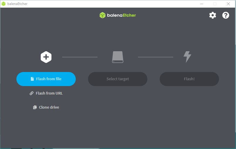

  4. Visit this link to download BalenaEtcher. We will use BalenaEtcher software to flash the Ubuntu image to a micro-SD card.
  5. Install BalenaEtcher and open it.
    Figure 1. Install BalenaEtcher
  6. Click Flash from file and select the location of the image where we just unzipped the following file:
    starfive-jh7110S-VF2-Lite-<Version>.img
    Tip: <Version> indicates the version number of the Ubuntu image.
  7. Click Select target and select the connected micro-SD card.
  8. Click Flash! to start the flash task.
