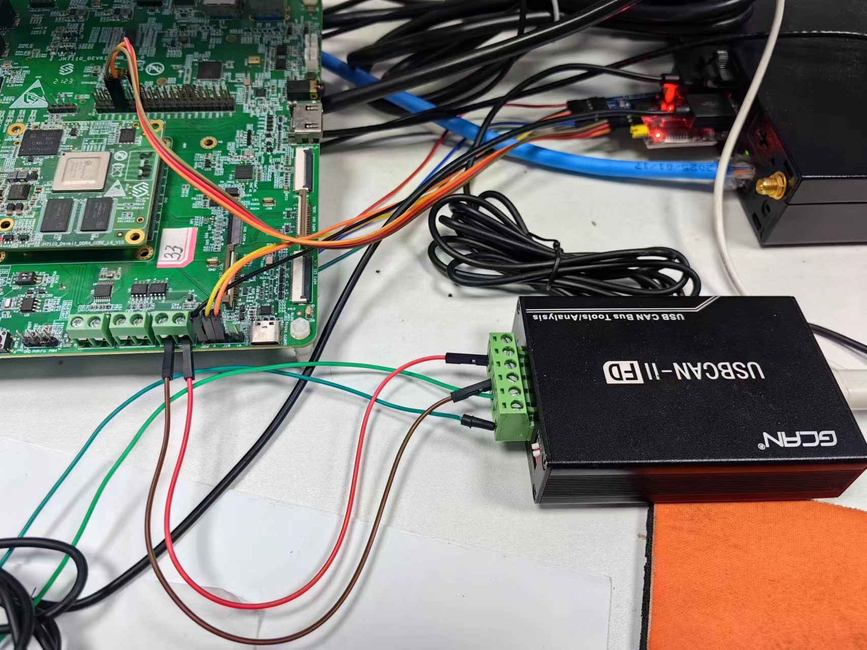

As the VF2 board does not have a CAN device transceiver, the test program must be run on the DevKit's board.
The following figure illustrates how a USB-CAN device is connected to CANO on the DevKit's board.
Figure 1. CAN Test Setup

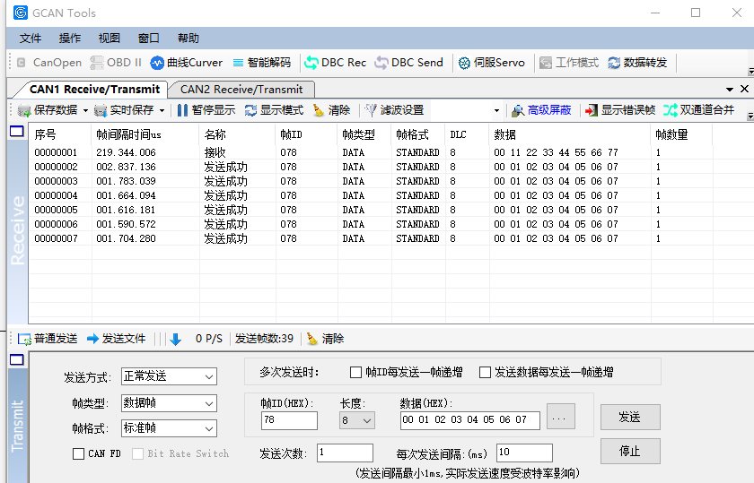

Running GCAN Tools on PC to send data frame via the CAN bus:
Figure 2. GCAN Tools

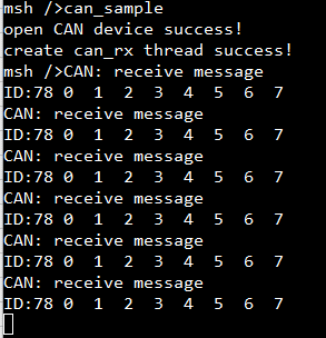

Figure 3. CAN Test Case
