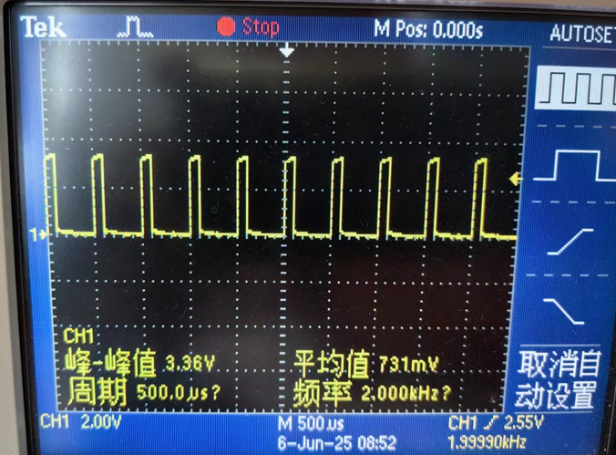

Read the PWM signal pins with an oscilloscope. The test result is shown as follows:
Figure 2. PWM Test Result
