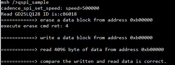

The test program below demonstrates how to use the driver interface to access the flash device.
Figure 1. QSPI Test Case
Test result: Read the SPI Flash ID and perform erase, write, and read operations. Compare the written data and read data to ensure consistency.
