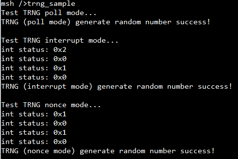

The RTOS includes a TRNG driver and a test program that is located at rtthread/bsp/starfive/libraries/driver/drv_trng.c.
Figure 1. TRNG Test Case
Test description: The test program calls the TRNG module to generate random numbers in poll mode, interrupt mode, and nonce mode.
