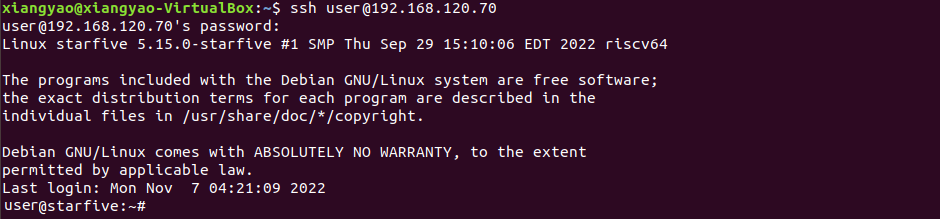

Open a terminal window and type the following:
Note: The following command is using user account as an example. If you need to login as root account, make sure you perform the previous step and change user as root in the following command.
ssh user@192.168.1.xxx
Tip:192.168.1.xxx
is the IP address of VisionFive 2. -
Type the password as starfive in the prompt.
Result:
Now you have connected with the VisionFive 2 via SSH using Mac/Linux!
Tip:192.168.1.xxx
is the IP address of VisionFive 2.Figure 1. Example Output
