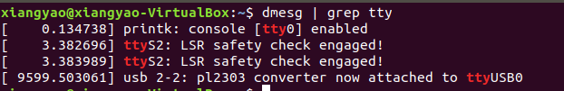

View the connected serial devices.
dmesg | grep ttyFigure 2. Example Output

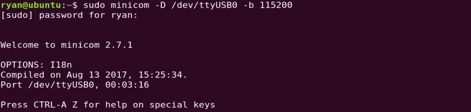

Connect to the serial device by typing the following command.
sudo minicom -D /dev/ttyUSB0 -b 115200Note: The baud rate is set to 115,200.Figure 3. Example Output

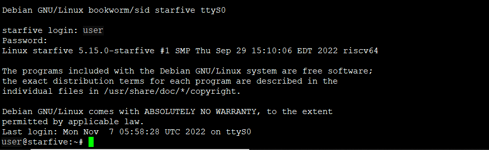

- Power on the VisionFive 2.
Type username and password in the prompt as follows:
Note: You can use either user or root account to login. The following example use user to login.
- Username: user
- Password: starfive
Result:Now you have connected with the VisionFive 2 via serial communication using MacOS/Linux!
Figure 4. Example Output
