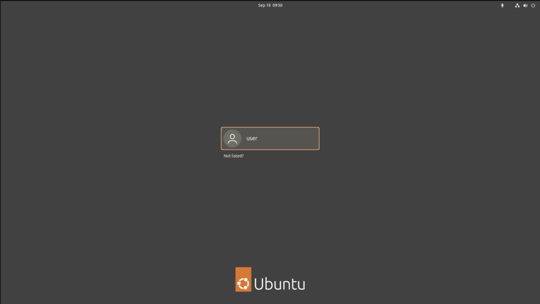

  1. After the HDMI of the display screen is connected, insert the micro-SD card with the Ubuntu image into the VisionFive 2 Lite and power on.
  2. After the desktop login system is displayed, you can use the keyboard and mouse on VisionFive 2 Lite.
  3. Enter the credentials as follows:
    • Username: user
    • Password: starfive
    You will see the following interface:
    Figure 1. Ubuntu Interface
