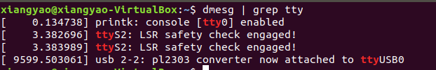

View the connected serial devices.
dmesg | grep ttyFigure 2. Example Output

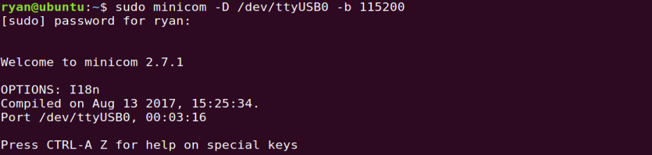

Connect to the serial device by typing the following command.
sudo minicom -D /dev/ttyUSB0 -b 115200Note: The baud rate is set to 115,200.Figure 3. Example Output
