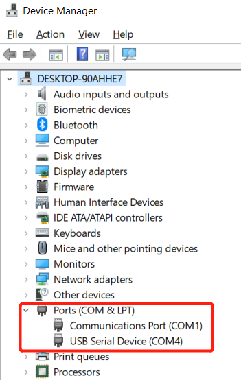

  5. Open Device Manager by typing Device Manager in the windows search box.
  6. Click the drop-down arrow from Ports (COM & LPT) and find the name of the connected serial port (e.g.: COM4).
    Figure 2. Example

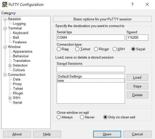

  8. Open Putty to connect the PC to the Carrier Board.
    1. Select Serial under the Connection Type.
    2. Configure the settings as follows:
      • Serial line: COM4 (choose your COM port)
      • Speed: 115200
      Figure 3. Example Configuration
      pir
    3. Click Open.

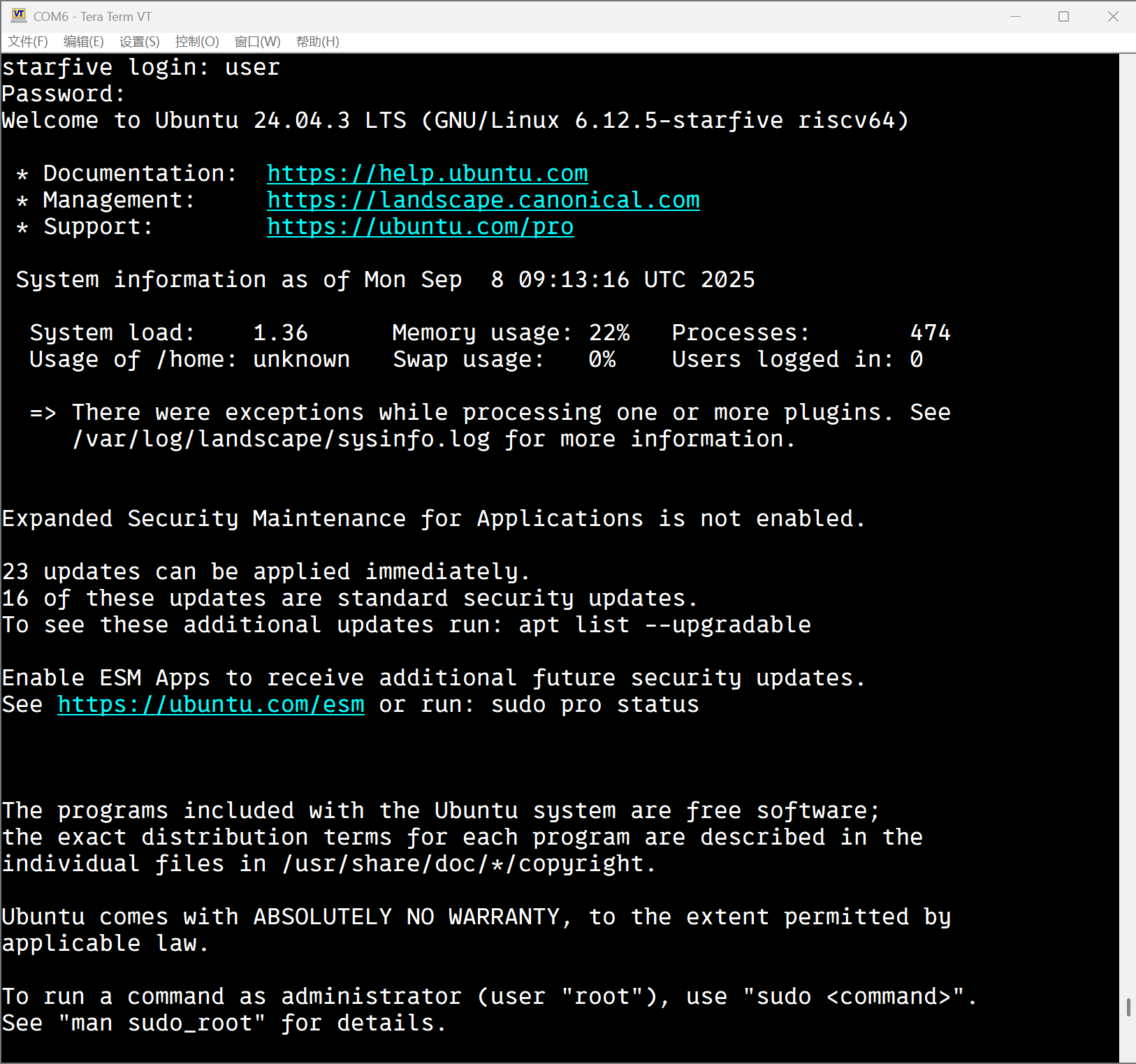

  9. Power on the VisionFive 2 Lite.
  10. Type username and password in the prompt as follows:
    Note: You can use either user or root account to login. The following example use user to login.
    • Username: user
    • Password: starfive
    Now you have connected with the VisionFive 2 Lite via serial communication using windows!
    Figure 4. Example Output
