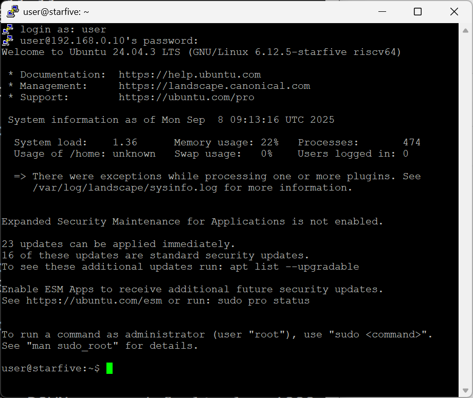

    Now you have connected with the VisionFive 2 Lite via SSH using windows!
    Figure 1. Example Output
